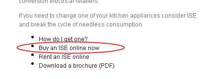

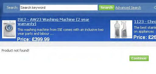

    Then maybe I am doing something wrong?
    I am following the link in the left hand column of this forum…
    I scroll to the bottom of the page and click the highlighted link
    I select a product or it’s details
    And get this…
    and that is for EVERY product on the page, not just the ISE2/5 which I know there is something happening with.

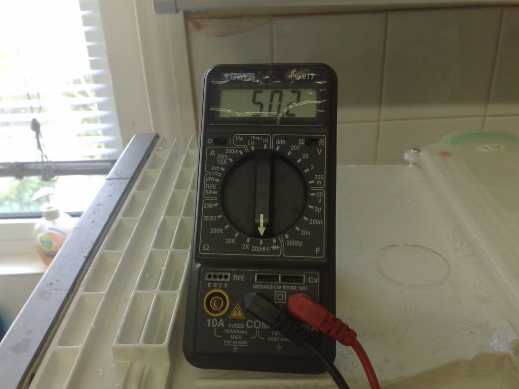

    Anyway, I finally took the DW apart today.
    I believe the heater is the silver tube 1/2 way down the r/h side of the following picture, just above what looks like the motor/pump.
    Pic 3
    There are 3 wires running into this unit, 2 at 1 end and 1 at the other. The 1 on its own appears to be earth, and running my meter between earth and either of the other wires gives no reading. However, running between what I believe to be live and neutral I get a reading of 50.5ohms (if I am reading my meter correctly, see following pic.
    pic 4

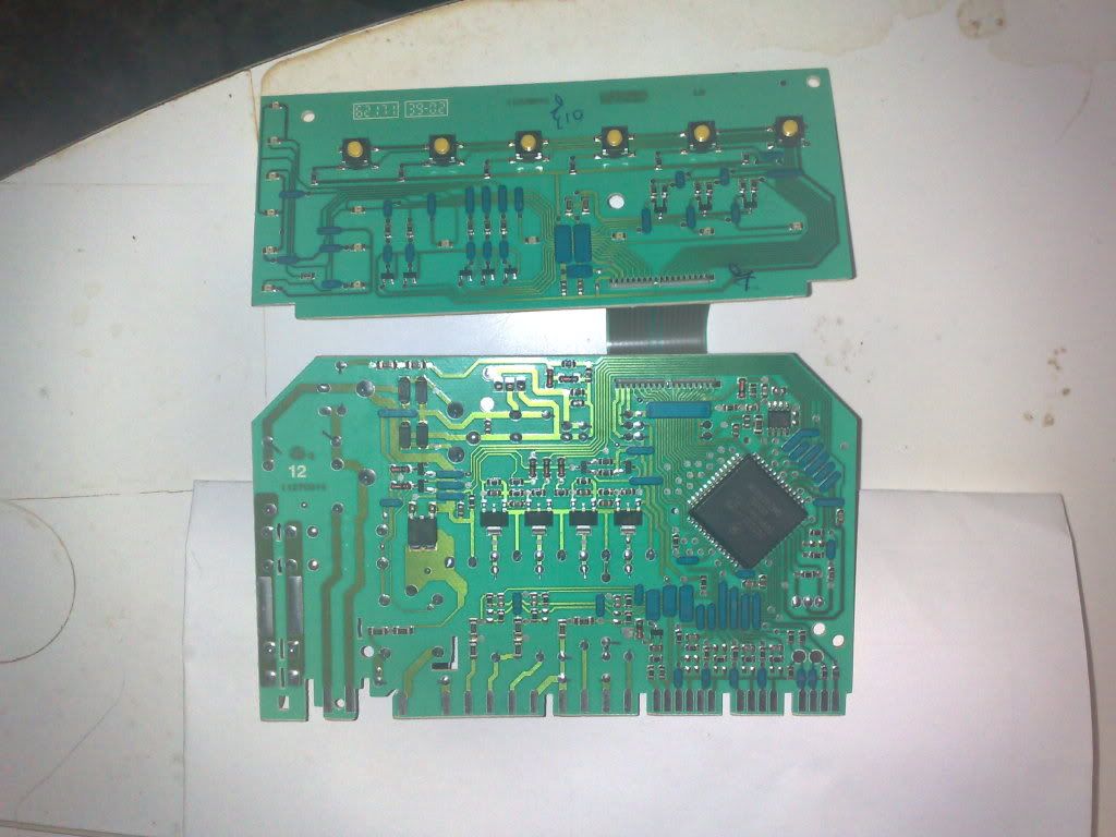

    I haven’t got round to putting a metre across the heater yet, but I have taken the door apart to look at the pcb.
    PCB Photo 1
    PCB Photo 2
    I cannot see any signs of dodgy connections. Any thoughts?
