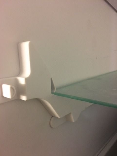

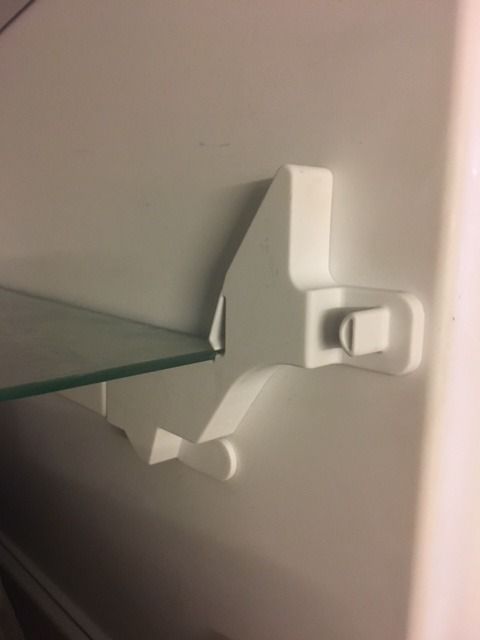

    clivejameson you Sir are a Gent, the bearers are indeed slide fit & there is a small plastic barb that needs to be lifted out to fit the bearer all fixed now.
    Thank you once again.
    You can see the circular bearer barb partially removed at the bottom of the bearer in the photo below.

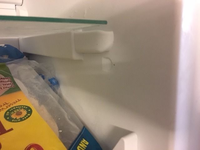

    Next photo shows the bearer removed and the barb location on the freezer itself.

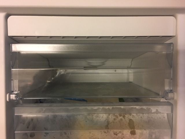

    Last photo shows the new freezer door flap fitted, Cheers clivejameson!

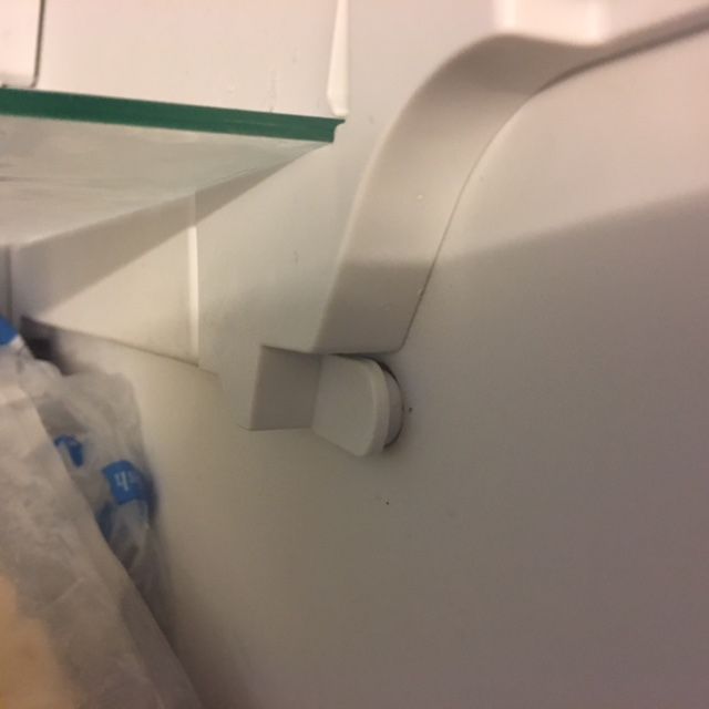

    Photographs of the left hand & right hand bearer below, items 0232 & 0233 in the diagram in the original post. I can’t see a fixing screw to remove them.

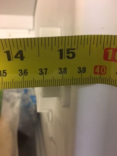

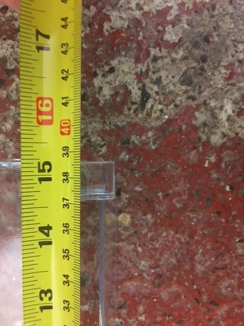

    I measured the drawer flap and it’s 385 mm long, the distance between the pins on the bearers is 370 mm, 2 photos below show that.

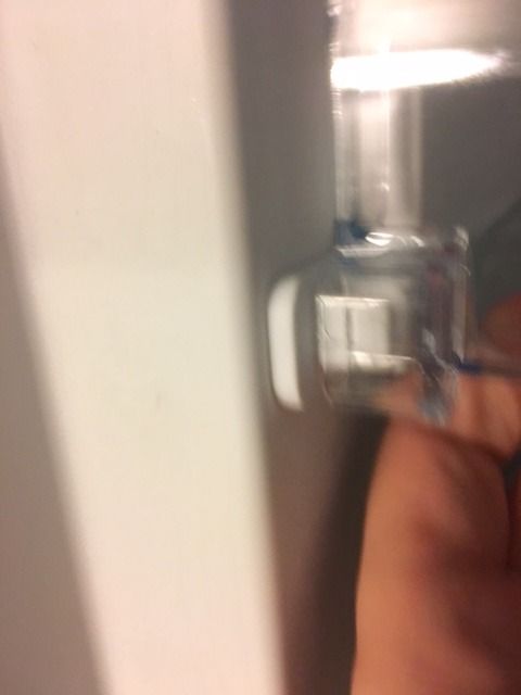

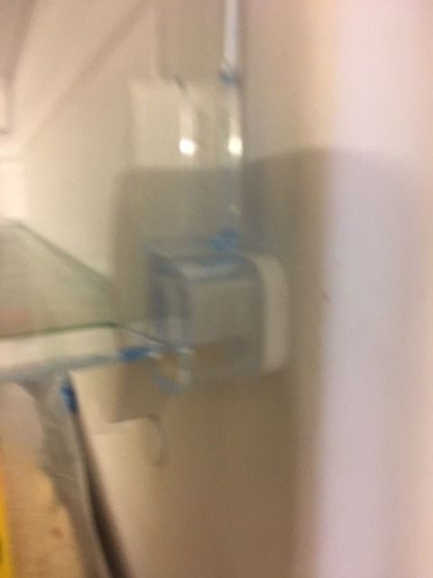

    The next two photographs show the drawer flap pushed up as far as it will go on the right hand bearer & once in this position how the left hand bearer / left hand corner of the flap looks (hard to manipulate the bearer pin inside the drawer flap without damaging either the drawer or the bearer.
