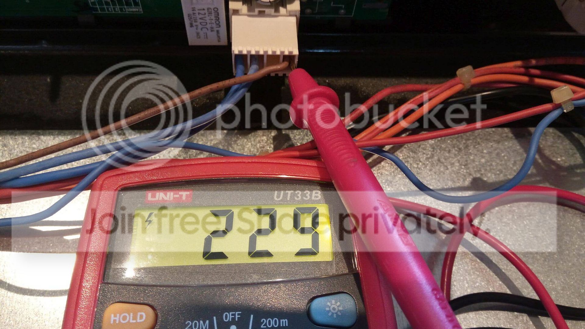

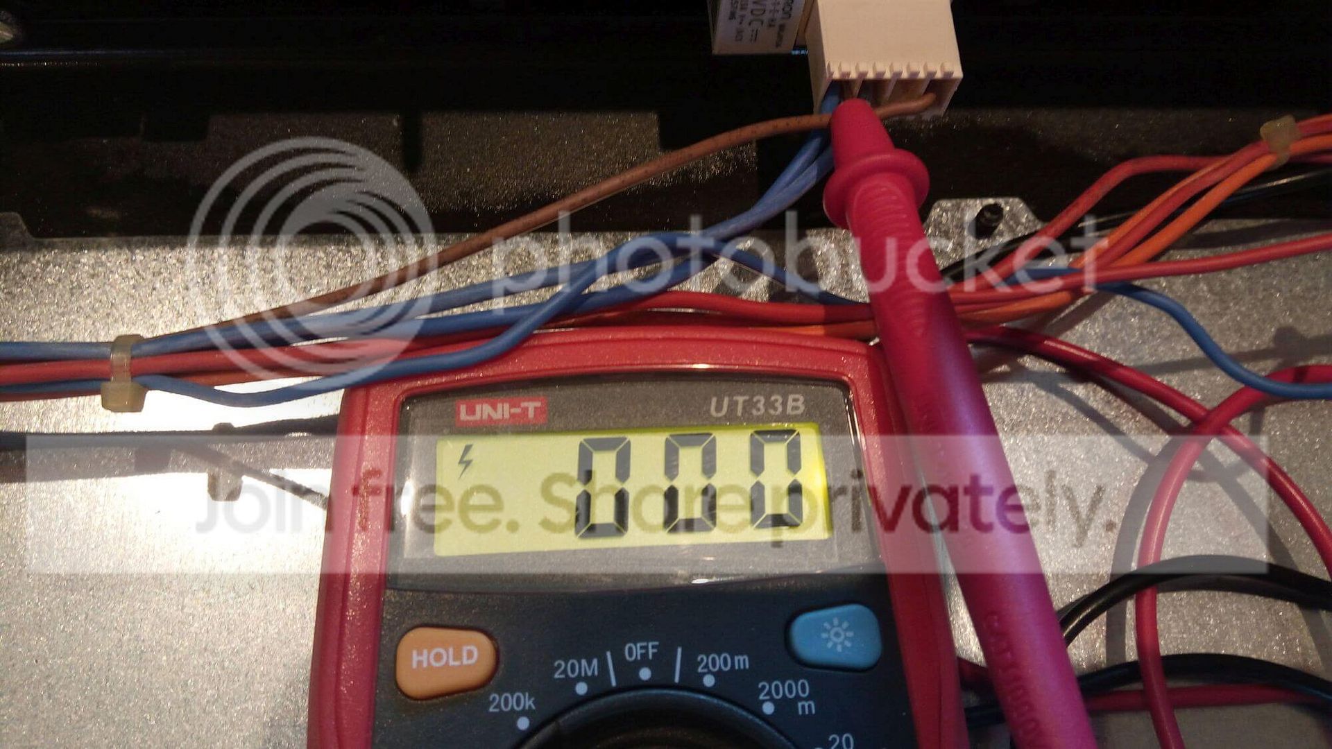

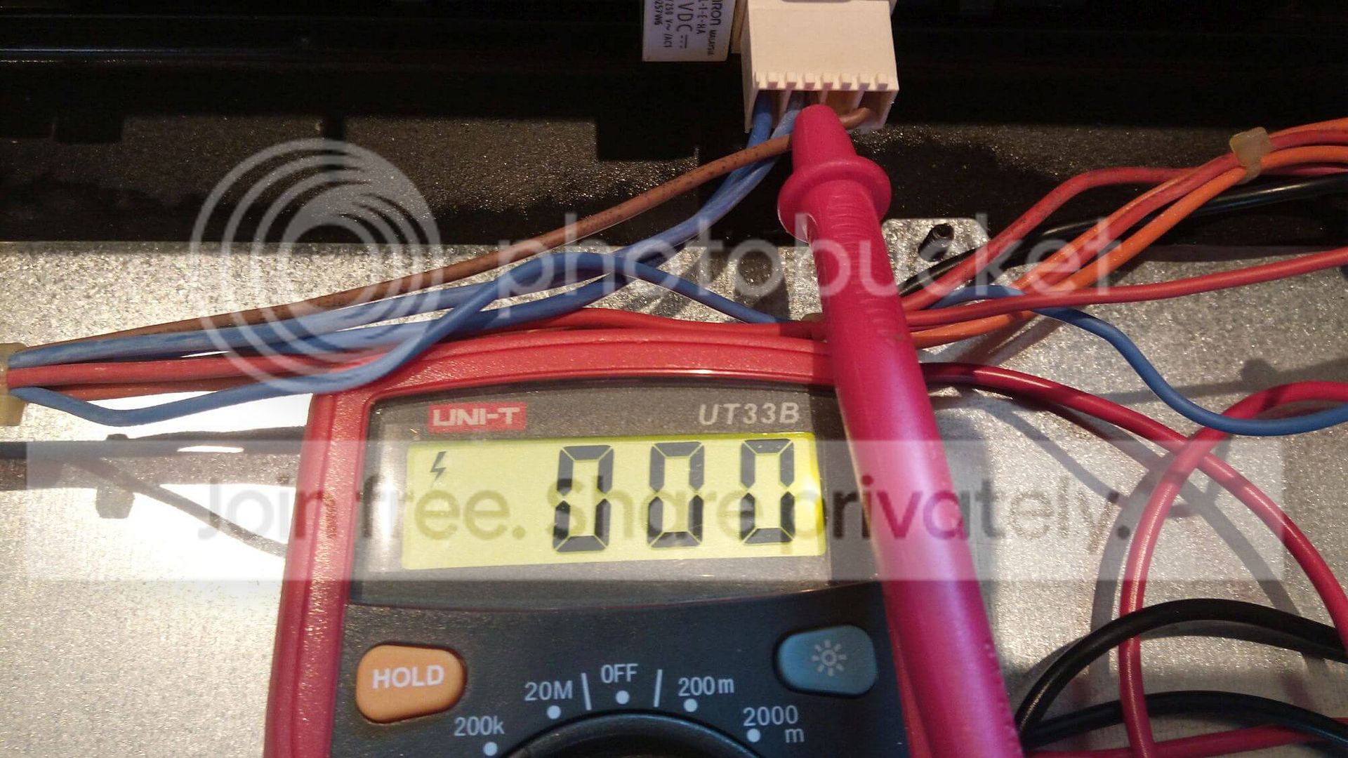

    Llyndonium
    Yes! The blue on the left is reading 230v and the one on the right (centre wire) is reading zero. So final check before I do it…. join the two wires…. I’ll have no clock/controller but the basic operations should work?
    We never use the timer, clock or auto functions so is it safe to continue to use in this modified state?

    Llyndonium
    There are three wires going into the board. Here are the voltages, tesed on a live circuit, earthing out to the body of the cooker. I take it this is normal?
