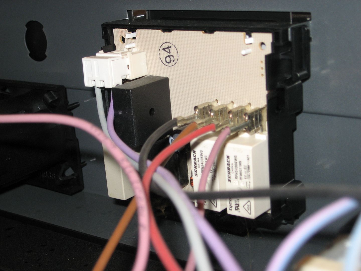

    in reply to: Neff Oven U1442 #434178
    nefftrouble
    Re: Neff Oven U1442
    Many thanks for the info, connections now changed and all seems to work Ok without any problems, much appreciate your time.
    in reply to: Neff Oven U1442 #434176
    nefftrouble
    Re: Neff Oven U1442
    Photo as requested.
    in reply to: Neff Oven U1442 #434175
    nefftrouble
    Re: Neff Oven U1442
    Will do that tomorow, thanks for advice.
    in reply to: Neff Oven U1442 #434173
    nefftrouble
    Re: Neff Oven U1442
    Thanks for the reply.
    You have guessed correct, we had a short circuit somewhere which tripped the Earth Leakage trip, since then the timer has never worked correctly and every time I reset the time, after a few hour it trips out and makes a wirring noise, tried all sorts of settings but nothig seems to work.
