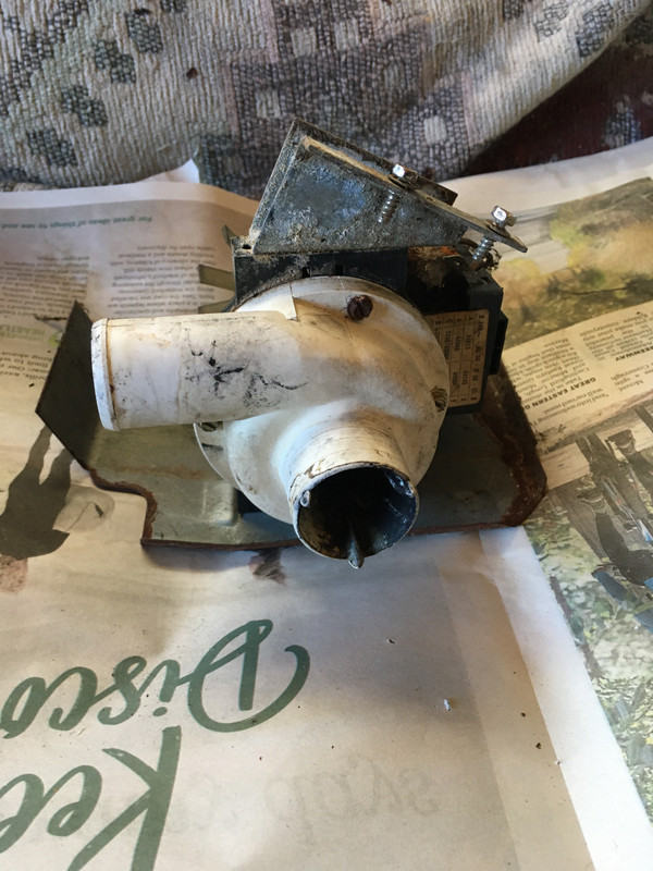

May 29, 2022 at 2:16 pm #481214inisfad
ParticipantSee if this works: https://i.postimg.cc/28gGS4vj/FE7-B2293-D2-C9-41-E2-B9-AF-C78-BEDA40935.jpg
That’s my pump.May 29, 2022 at 2:19 pm #481215inisfad
ParticipantI suppose I need the whole thing, if possible…the pump part and the electrical part??

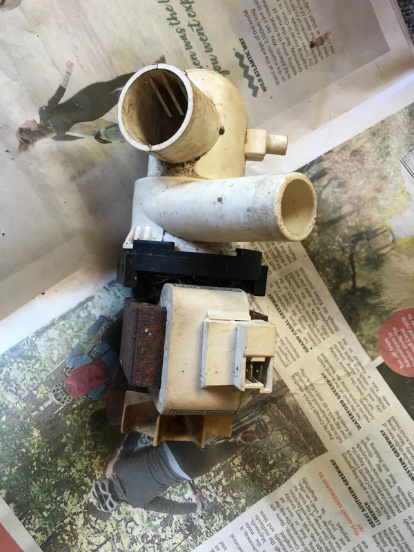

ParticipantYou know, I really shouldn’t be let out of the house without someone in a white coat with me. Sorry about the above photo….that’s actually the one that I replaced some years ago, for my US top loader. This is the pump for the. Hotpoint:
https://i.postimg.cc/PxjdZtVp/5795-CDF1-416-B-4-A87-92-CB-1-F1-C2-B8933-C7.jpg
I’ve even found the part number. 160225. Of course, in googling that, no one has it.May 29, 2022 at 3:22 pm #481218inisfad

May 29, 2022 at 6:07 pm #481220inisfad
ParticipantYou’re assuming that English is my primary language (it is….lol). Anyway, after looking on the internet, it appears that finding a new old stock replacement for this is going to be a non runner. Just for the heck of it, I took the outer cover that holds the inlet and outlet hoses. It doesn’t look like there much inside to actually leak. Behind the cover, under the little ‘propeller’ is a large black rubber gasket, where the circumference of it sits is a small channel. From the discoloration and rust on the bottom screw holding the cover on, it looks like this gasket was leaking from the bottom. I cannot see a way to take this gasket off, as it’s behind the propeller, and I don’t readily see a screw or any way of removing that. Was that gasket supposed to be glued around the rim to the plastic piece behind it? (It wasn’t). The electrics on the pump were working (at least for now). Have you ever repaired one of these things? Maybe Debhor around the rim of the gasket? Any ideas (or any suggestions to get a new pump?? My concern about something aftermarket is having to modify it to install it properly)….????
