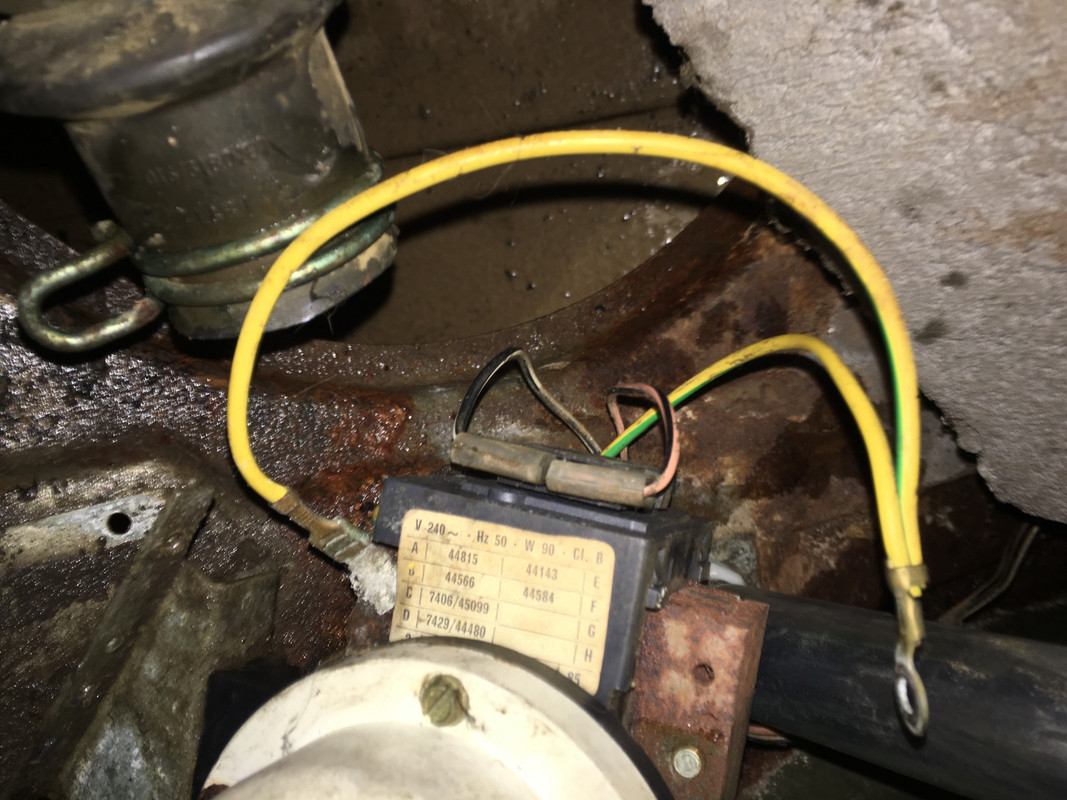

    Good day!! I’ve received my replacement pump. Before I screw this up, I want to just confirm a few things. This is the photo of my old pump:
    https://i.postimg.cc/9Q97B9yT/561-E993-E-2608-4-C56-9-E6-F-A1-CE0-ED54-B27.jpg
    That yellow/green wire was connected in two places…one connection on the (corroded) spade connection that you see just to the left of the label, and one connection (using the ‘eyelet’ connection to the right of the pump) that went to a metal ‘pump cover’ that was on top of the pump. I’m assuming, then, that both of these connections were the ground/earth, and that I do not need either of them??
    Do I need the metal plate that covered the original pump?
    Also, the bottom of the original pump sat on this metal bracket:
    https://i.postimg.cc/5yL2cBpW/E522-FE67-982-C-40-AA-AB39-D0-FF10-B812-A6.jpg
    Do I still need this bracket, or can I screw the new pump directly into the floor panel of the washer??
    It looks like the connector for the wiring is on a different side of the pump. I haven’t opened the machine up yet, but hopefully I’ll have enough wire to get to the new connectors, without having to modify. And just to confirm the advice from above…..there is no polarity that I have to worry about. Is that correct????
