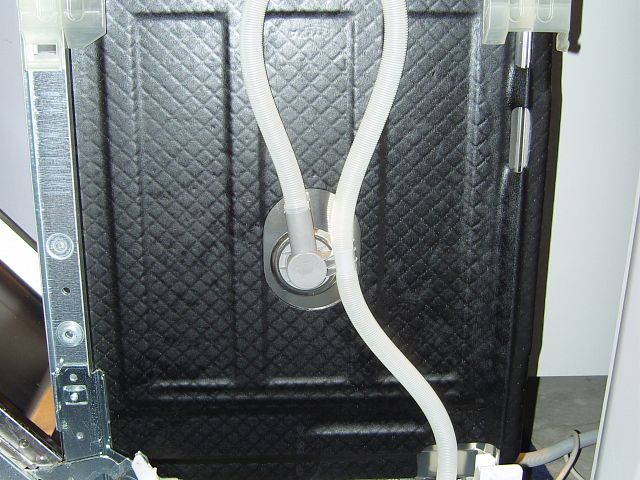

January 21, 2014 at 9:18 pm #408059alexanderfoti
ParticipantJanuary 21, 2014 at 9:51 pm #408060Martin
ParticipantRe: Neff S5943X2GB Integrated washer being a pain!
Now get handy with your multimeter. 😉
