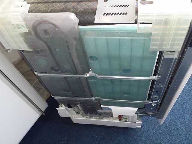

    Left panel off:
    65 degree setting on.
    Water drains for 20 seconds. Valve opens, water travels up the right hand channel, up and down again, past the float sensor.
    The white pluger pushes the microswitch open whilst the water is flowing. It then closes after the water flow stops.
    The red plunger never gets actuated.
    Thoughts?
    #408082
    Re: Neff S5943X2GB Integrated washer being a pain!
    Does the water matrix fill right to the top before syphoning it’s entire contents into the tub?
    #408083
    alexanderfoti
    Which one is the water matrix:
    Both the left tanks are full to the top the whole time.
    #408084
    The bluish one on the right fills up and overflows its entire contents into the tub.
    #408085
    alexanderfoti
    Aha, that never happens. Its full but it never empties its contents into the tub. I will video the fill procedure.
    #408086
    Don’t trouble yourself, instead replace the drain valve below that water container as it’s obviously not opening (faulty solenoid coil or jammed).
    #408087
    alexanderfoti
    Excellent, Many thanks!
    Of theese, which is it:
    http://www.partmaster.co.uk/catalogue.p … fine=valve
    #408088
    alexanderfoti
    I gave the back of the valve a tap with a screwdriver handle. All sorted now 🙂 IF it gets stuck again, I know what it is. Thanks for your help.
