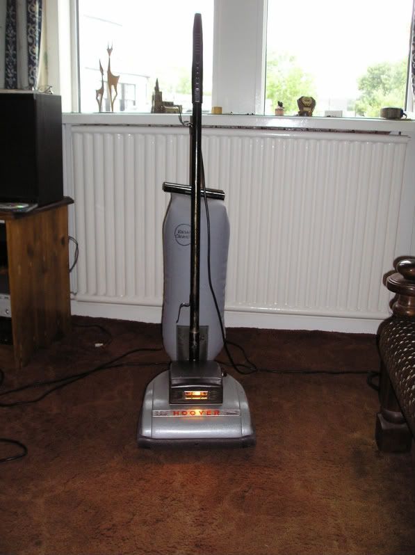

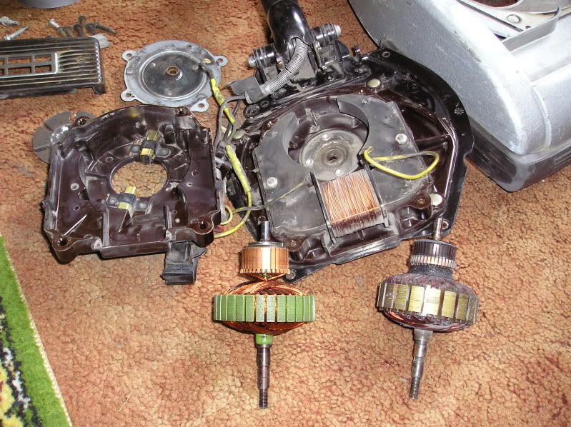

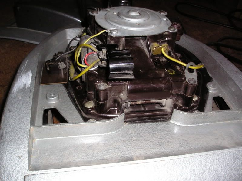

    I did some repairs on this Hoover 912 a few years ago but it came back last week. This time it was only a minor problem, an internal break in the mains cable where it enters the handle. The cable protector had perished and gone floppy so I found a suitable replacement off a more modern vacuum. I have some spares for older machines recently acquired from Bill Ellis who has retired. I knew there were a few armatures so I checked and found one to fit. The winding pattern is different but it is obviously the same size etc so I fitted it and it works fine. I can’t charge the customer for the armature but thought it was better to use it than it just eventually getting binned. I got a new 25 watt pygmy bulb and the machine is almost ready to go back. The only thing I have to sort now is the On/Off switch. There is nothing to positively position the switch in the handle but if not precisely square with the hole in the escutcheon there is not enough throw and it fails to switch off. I will need to put packing behind the switch to force it hard against the escutcheon. I don’t know how old the machine is but this model was introduced in 1950.
