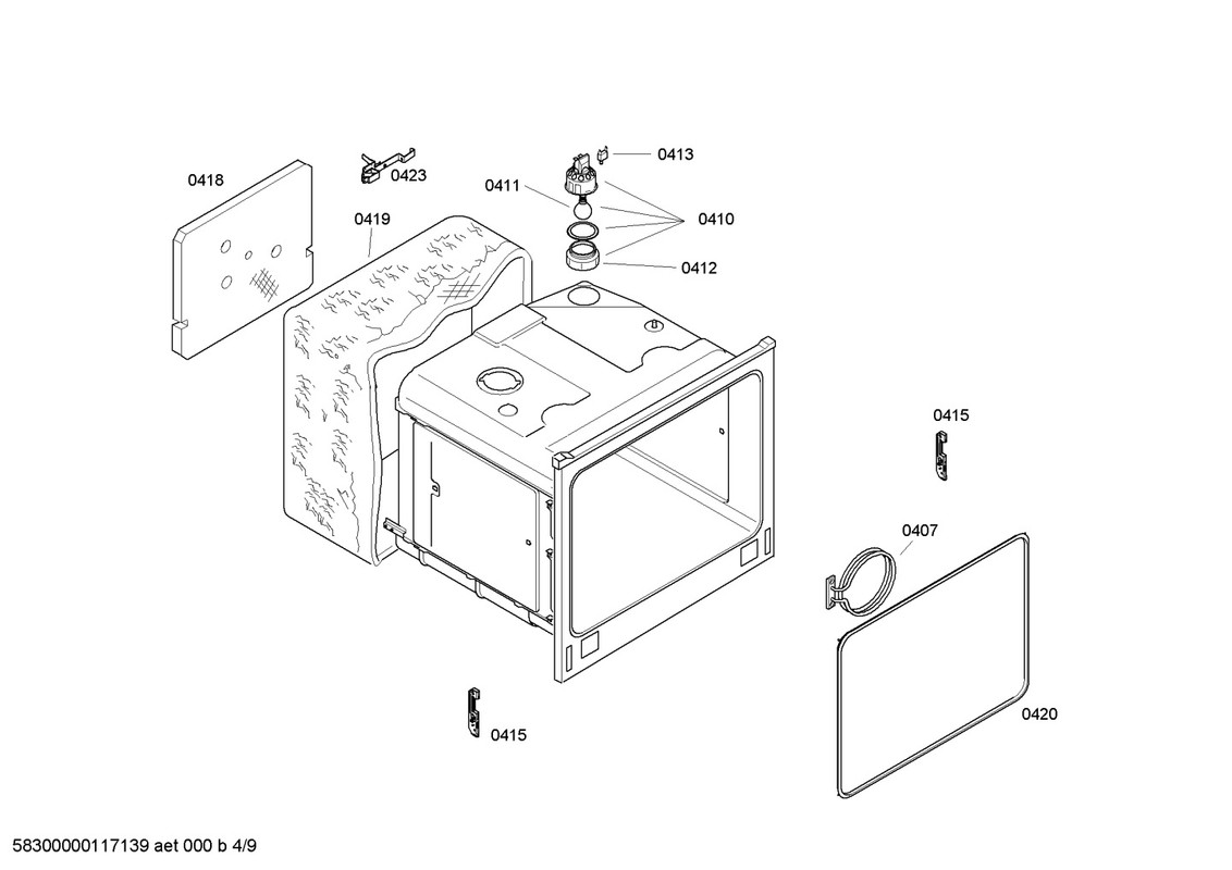

    OK, got the main control switch off [only half-broke the fixing – it click-fits into a collar around the hole in the front plate]. Examined switch – no sign of wear or overheating. Reassembled. Oven still works as normal, but replacing the lamp bulb it blows on switching lamp on and trips rcd. Suspect lamp assembly. There is a switch attached to the lamp assembly, which does what, I don’t know. Marked 0413 in image.
    Any ideas anyone?

    It looks like it: six pairs connectors. Tells its own story in that the site doesn’t list the upper oven selector – which is truly only a function selector, not heat and function, so would rarely cause problems. It’s just a case of how to get it off though. On the parts diagram is 0231: ‘support’, which is fixed to the top panel somehow, and the selector may be screwed to that. I cannot see any visible means of support. It may even be a tabbed press-fit, in which case I’d best order another as well, I always manage to break one too many tabs. Hopefully someone has tackled this job before.
