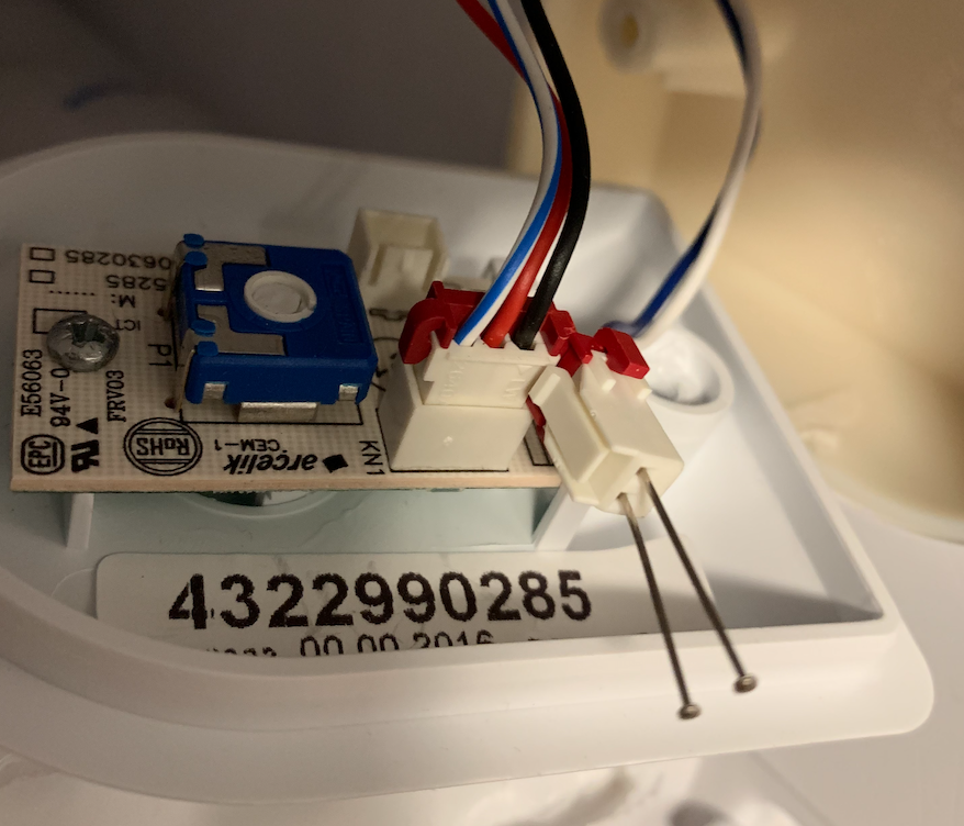

ParticipantMostly for the benefit of the search:
As suspected, the wiring defrost stat is connected via the PCB behind the temperature control knob. Therefore, the sensor can be tested easily from this point without cutting anything with the aid of a couple of sewing pins (and obviously a multimeter then connected to them, to read the measured resistance across the sensor):
[IMG2=JSON]{“width”:”400″,”height”:”343″,”data-align”:”none”,”data-size”:”full”,”src”:”https://i.postimg.cc/vm1rtGCG/Screenshot-2020-05-07-at-20-24-43.png”}[/IMG2]

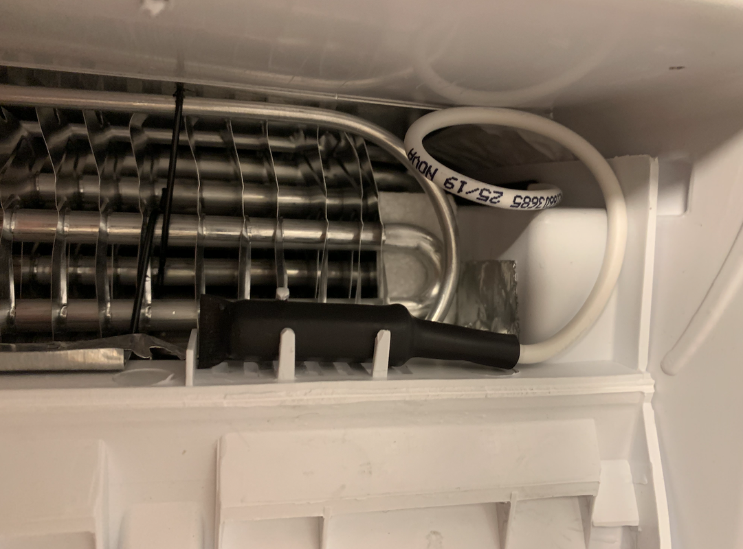

The stat *can* be replaced, it’s mounted behind the air inlet at the top and the correct part is 4394720185. There is no cable slack whatsoever. Therefore, the old sensor needs to be cut as close to it as possible, to leave enough cable left to strip back to solder to. The full loop mounting clip also needs to be cut as the replacement sensor is a little larger due to the heat shrink and the flat end of the heat shrink also needs trimming a little:
[IMG2=JSON]{“width”:”400″,”height”:”296″,”data-align”:”none”,”data-size”:”full”,”src”:”https://i.postimg.cc/wT7jv3Nx/Screenshot-2020-05-07-at-20-24-18.png”}[/IMG2]
Having replaced the stat, the defrost is again working but it still doesn’t fully clear the evaporator, especially at one side.
Because of the connection behind the control knob, it seems doable to add a resistor inline to the sensor to bring it back in to spec and/or alter the defrost profile. The PCB does nothing whatsoever except provide a connection to it. I intend to add maybe 4k7 resistor inline and see that helps… the resistance of the sensor reduces as temperature increases, therefore adding some resistance will make the controller think the evaporator is colder than it is, hence extending the defrost cycle (hopefully).
