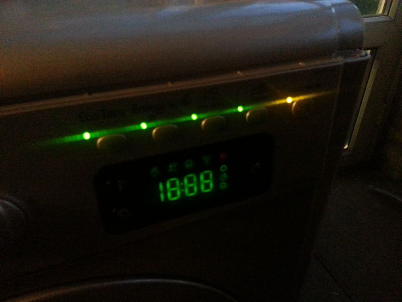

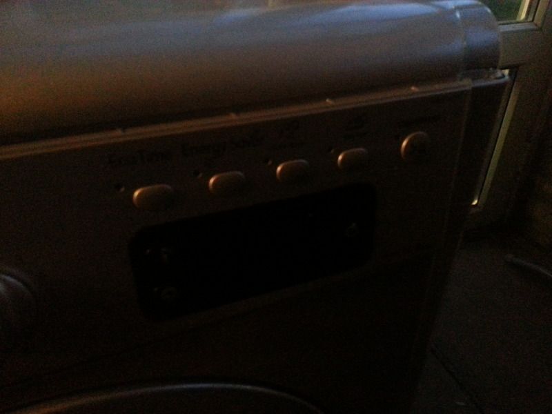

    sjoyce666
    Re: Indesit IWE81481 – Front Panel Flashing
    Lights On
    Lights Off
    Video can be found here
    http://vidmg.photobucket.com/albums/080 … 046281.mp4
    This cycle continues quicker than every second
    Scott
