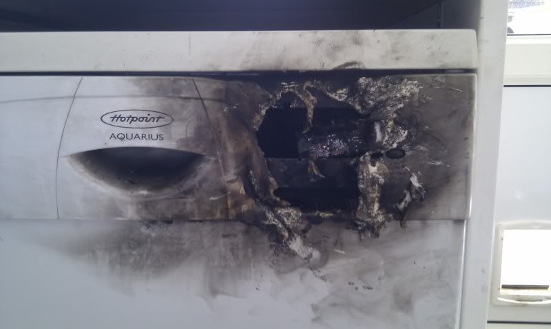

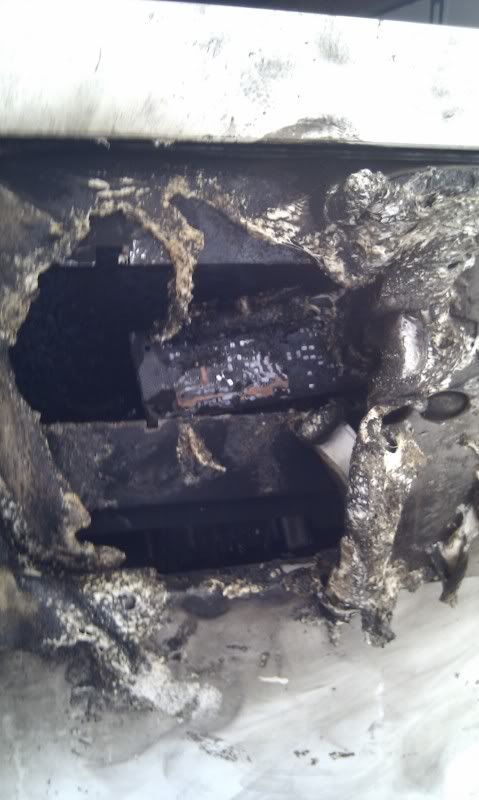

    How did you get on? Until the other week i would have said don’t be too concerned but i did attend one of these for an insurance assessment…..
    I think it was fortunate that in this particular kitchen the worktops were stainless steel normally only seen in commercial kitchens and not in a residential property like this was. There were signs of heat damage to the worktop and the smoke damage was considerable. There was also some damage to the flooring where the housewife had beaten the flames down with a damp cloth which had flicked molten plastic about! 😯
    #356962
    bertieboo
    Re: Advice needed – Safety Issue!
    OMG!!!!!
    As yet, I have not contacted Indesit since my last message as i’ve just been too busy. That picture has really freaked me out 🙁
    Genuine thanks sent though for showing me.
