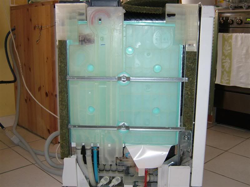

    Cheers Penguin,
    Well, I took the side off today, to look for anything obvious & check all the pipes were clear. Drain pipe to the sink was all clear, inside the machine looked all nice & clean, so I put it all back together again, and as if by magic, it seems to be working again as normal. 😕 I tipped it on it’s side, and banged it about a bit, so maybe it’s dislodged something, who knows.
    Anyway, the only thing out of the ordinary I found, was bit of gunge inside the heat-exchanger tank thingy. It’s at the top left in this picture. Looks like mould, but I don’t think there are any controls or sensors that might be getting fouled, at this point, are there?
