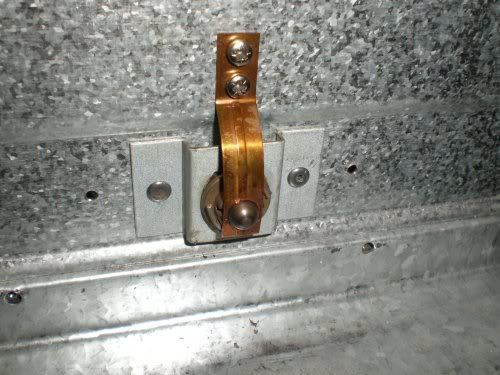

  • in reply to: Hotpoint Aquarius TDC30 #274419
    dnaxton
    Re: Hotpoint Aquarius TDC30
    Penguin45 wrote:Earth strap. No longer fitted on newer machines as the drum now runs on a phosphour bronze bearing rather than the old Polypenco plastic one.
    Would this cause my machine to blow a plug fuse
    Regards
    in reply to: Hotpoint Aquarius TDC30 #274418
    dnaxton
    Basically i have just noticed that mine has worn through.
    in reply to: Hotpoint Aquarius TDC30 #274416
    dnaxton
    Springnuts wrote:Hi dnaxton
    Looks like a Snurble Grip Thribley to me – but it’s an unusual design. Is the machine a ‘grey’ import from the continent perhaps?
    Regards
    Springnuts
    Cheers for your very help reply.
    The Snurble Grip Thribley is the part behind the brass/copper strip.

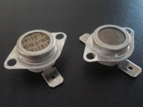

    in reply to: Hotpoint TDC30 (Not Heating) #247376
    dnaxton
    Re: Hotpoint TDC30 (Not Heating)
    iadom wrote:Definitely faulty, handle any new green spot one with care, do not press it under any circumstances. The one that clicks is the cycling stat that controls the temp, the green spot one is a ‘one shot’ safety stat that will not reset.
    Also make sure the condenser unit is completely clear.
    My dryer was a bit like the one in this link
    http://www.ukwhitegoods.co.uk/help/fix- … lures.html
    Now cleared
    in reply to: Hotpoint TDC30 (Not Heating) #247374
    dnaxton
    Cheers for the quick reply.
    The one with the green dot on is dished in. 😉
    The other still clicks up and down when pressed
