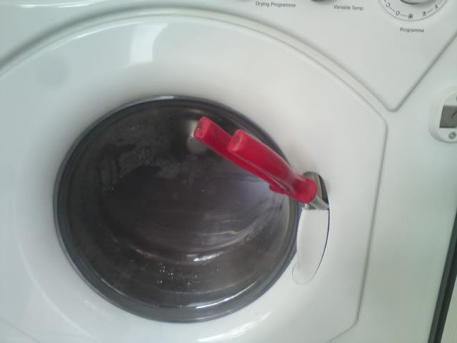

    in reply to: Tips, Tricks & Shortcuts #290427
    mjjuk
    Re: Tips, Tricks & Shortcuts
    DDDave wrote:The way I open the Indesit/Hotpoints is to cut off the top of the handle with a snips and then use a long nose pliars to pull the latch pin up.
    Rather than break the handle unscrew the lid and reach inside and push over the latch from the inside
