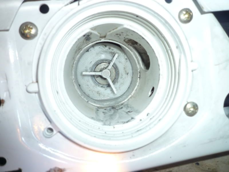

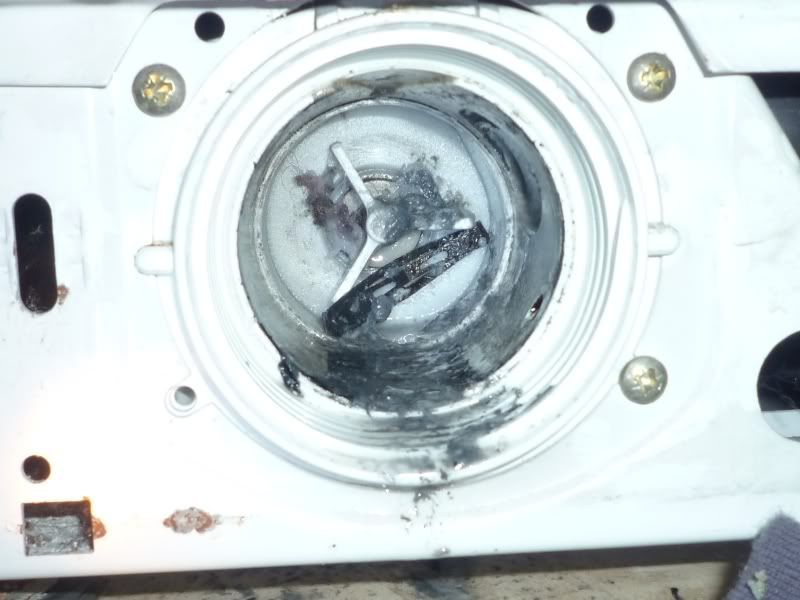

    in reply to: Bosch WFF2000 – no draining or spinning at end of cycle #312780
    Rafkoo
    Re: Bosch WFF2000 – no draining or spinning at end of cycle
    All done… see if you can spot the offending item below…. :rolls:
    Not tested yet, but think that may be the prob….
    And once given a bit of a clean…..
    Not tested yet… wating for the missus to try that after showing her the problem in glorious technicolour….. πŸ˜†
    Thanks everyone!
    Raf
    By the way, one of the screws was already missing… that wasn’t me… πŸ˜‰
