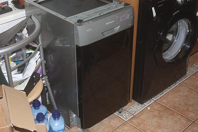

    Re: Removing front cover of Dishwasher
    After much headscratching i found out the reason it was not releasing detergent was i knocked the connector for the detergent release mechanism off when putting the door back on
    Still the silver panel and door sprayed in Ford Metallic black looks alright
    Well i got the metalwork of the door off and got it resprayed by my friendly car bodyshop and it is looking good BUT now the machine has an odd problem – will start a new thread
