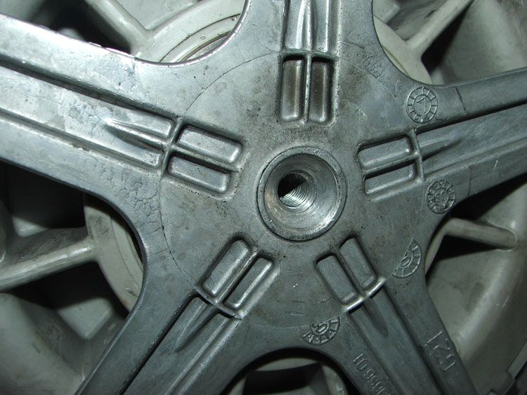

    in reply to: Zanussi FJDR bearing change – removing pulley #383887
    Bertie78
    Re: Zanussi FJDR bearing change – removing pulley
    Great, so I have possibly screwed the job up without knowing it. Oh well, I am an amateur I suppose. It has two tiny score marks on the upper edge of the brass bit. I might just spend a tenner for the bearing kit and see what happens. I guess I enjoyed taking it apart, and I feel like completing it. The spider is £100 though.
    in reply to: Zanussi FJDR bearing change – removing pulley #383885
    Bertie78
    Thanks, I was sure it was a bearing – but I was wrong. I’m still considering buying another crosspiece as the replacement is expensive for this model. Is a wire brush the best thing to clean all that build up on the back of the cross piece and drum, or is there some kind of limescale removal type liquid I should get to do it?
