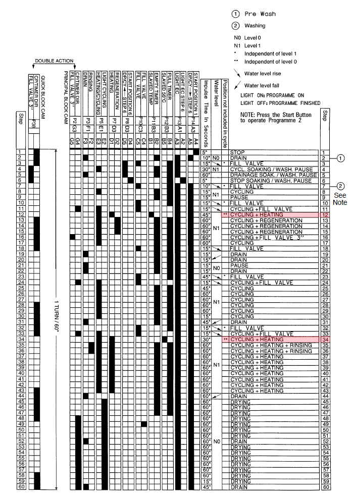

    I have bought myself a multimeter, stripped the casing off and this is what I have found.
    1. When it hits program 12 and 34 (see chart on previous page – both these stages are when the heater is turned on) power to the motor of the timer unit is cut and sticks on that cycle.
    2. Power is directed to the heater element, and has been checked and returns 234v and 26ohm, and heats as per normal.
    3. I have checked for continuity over the dual thermostat and all is fine.
    4. I have traced the power feed to the timer motor and one side goes back to the start button and the other goes to this thing: (it is located on the same block as the mains flex coming in from the back): What is it/would it cause my problem?
    I am starting to think that its the timer. I dont like buying parts for the sake of it, so can anyone give me any other test to perform whilst its apart?

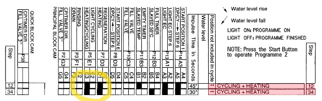

    Here is an indetail slice of the 2 erroring phases:
    All I can see is that the common item is heat…ie the thermostat is not pinging the timer to say that it has reached temperature.
    Infact I feel we are getting closer to the route of the cause, if you look at the full chart above, the timer is stalling at both the only points where heat is required.
    in reply to: Bernstien Dishwasher playing up AGAIN #296886

    I did a test, after cleaning out and it all heated well, but still the same problem persists with the timer. TBH I am thinking it is not the timer, as it sticks in 2 places, and if you look at the chart below, I have hightlighted them both, and they are the same function. It just refusses to move on from this phase, and if I give the timer a manual click round it continues as it should, washing perfect, with loads of heat.
    My thinking is that it is waiting for some sort of signal, the same signal infact before it will move on to the next phase.
    If I/we can work that out, I think we have the route of the problem. As I have learnt the hard way, it does not pay to go buying parts on a whim!
    Take a look, it seems to indicate in the key **
    The thermostat has been tripping and I have lost heat, but clicking the reset works. I think its tripping because it is sticking on the cycles below, and getting too hot…or is that the route of the problem?
