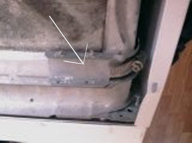

    in reply to: Brandt Dishwasher similar to Hotpoint BF41 hinge assy #250841
    bobokines
    Re: Brandt Dishwasher similar to Hotpoint BF41 hinge assy
    Thanks Mark. That’s the one :tup:
    Great stuff
    Bob
    in reply to: Brandt Dishwasher similar to Hotpoint BF41 hinge assy #250837
    bobokines
    Just to be sure, this is the bit I need…
    bob
